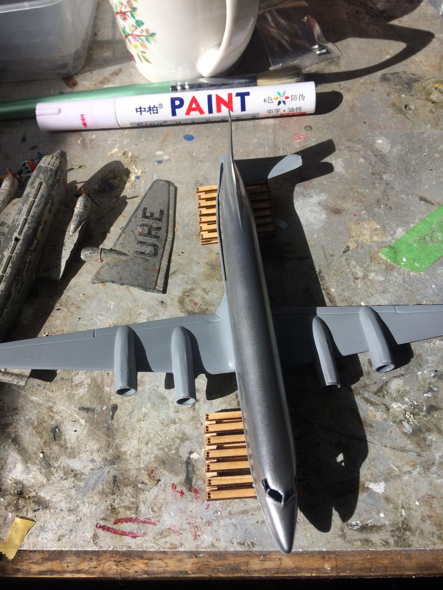

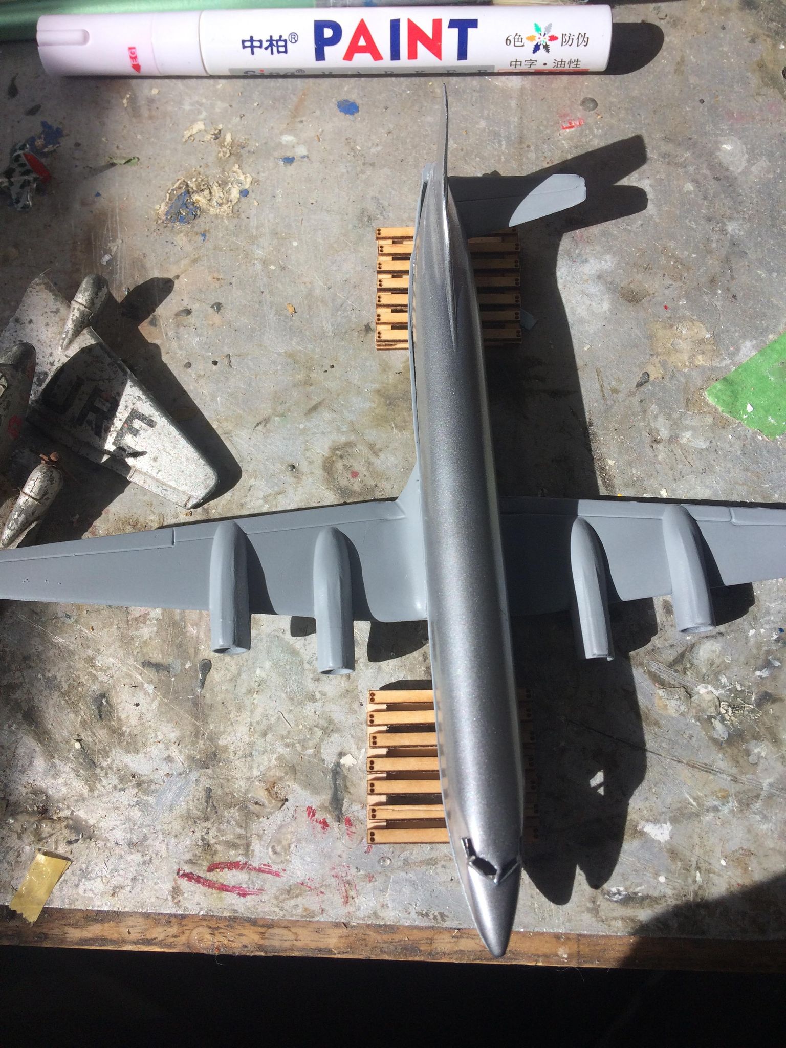

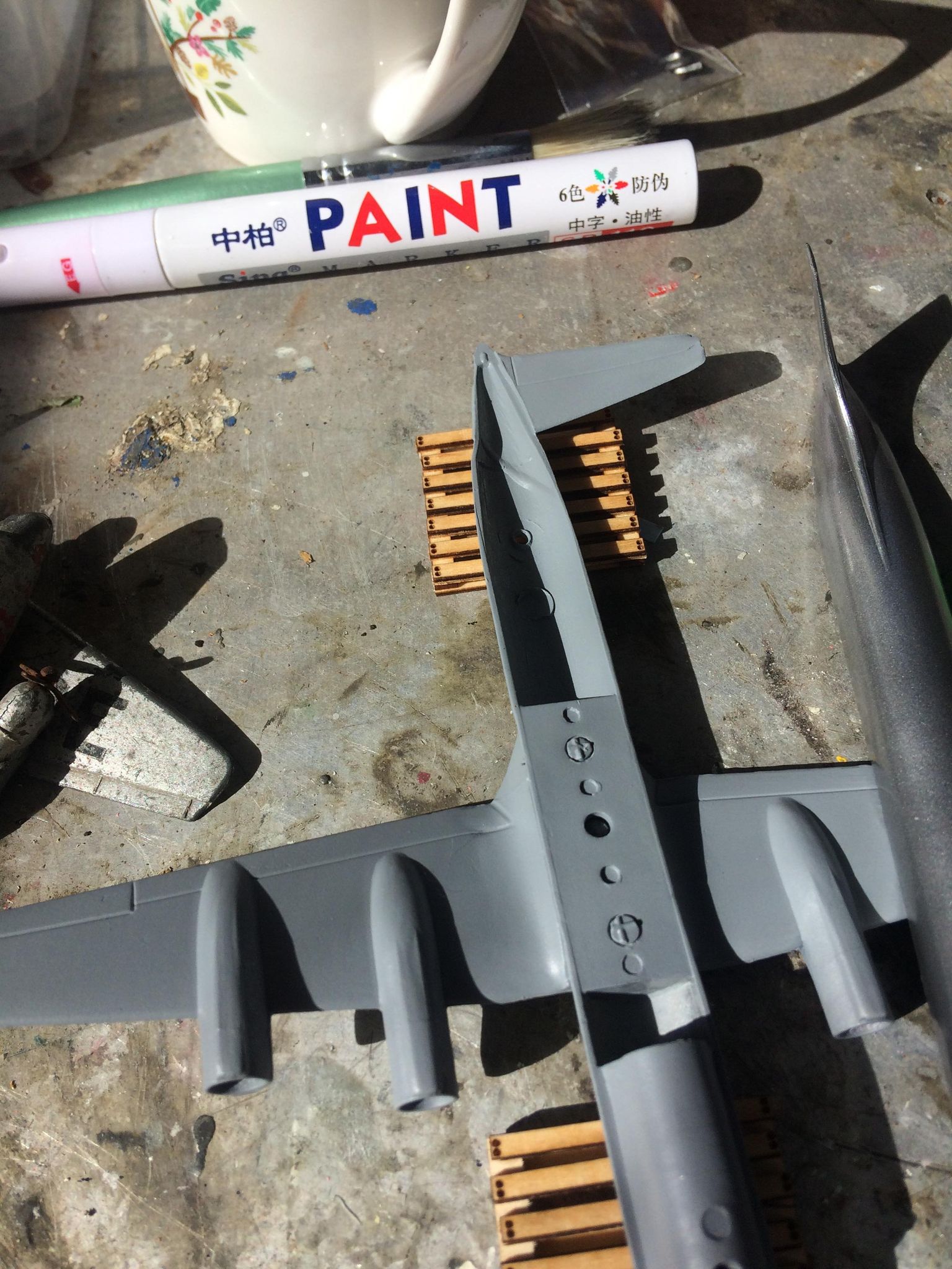

Participanthi , fellow Tekno addicts I have finally made a start on the Douglas DC 7 , missing one
section of tail fin also broken locking pin at rear of body and broken window pillar .
I have just ordered missing wheels motors and propellers along with decals from Peter ,
they should arrive in Australia in around 2 – 3 Weeks , plenty of time to get it looking
how it should, ready for fitting of new bits .I have plenty of other repairs to do along with this so always busy , will keep updates posted as I get it finished .juni 30, 2021 kl. 14:09 #79200shane holmyard

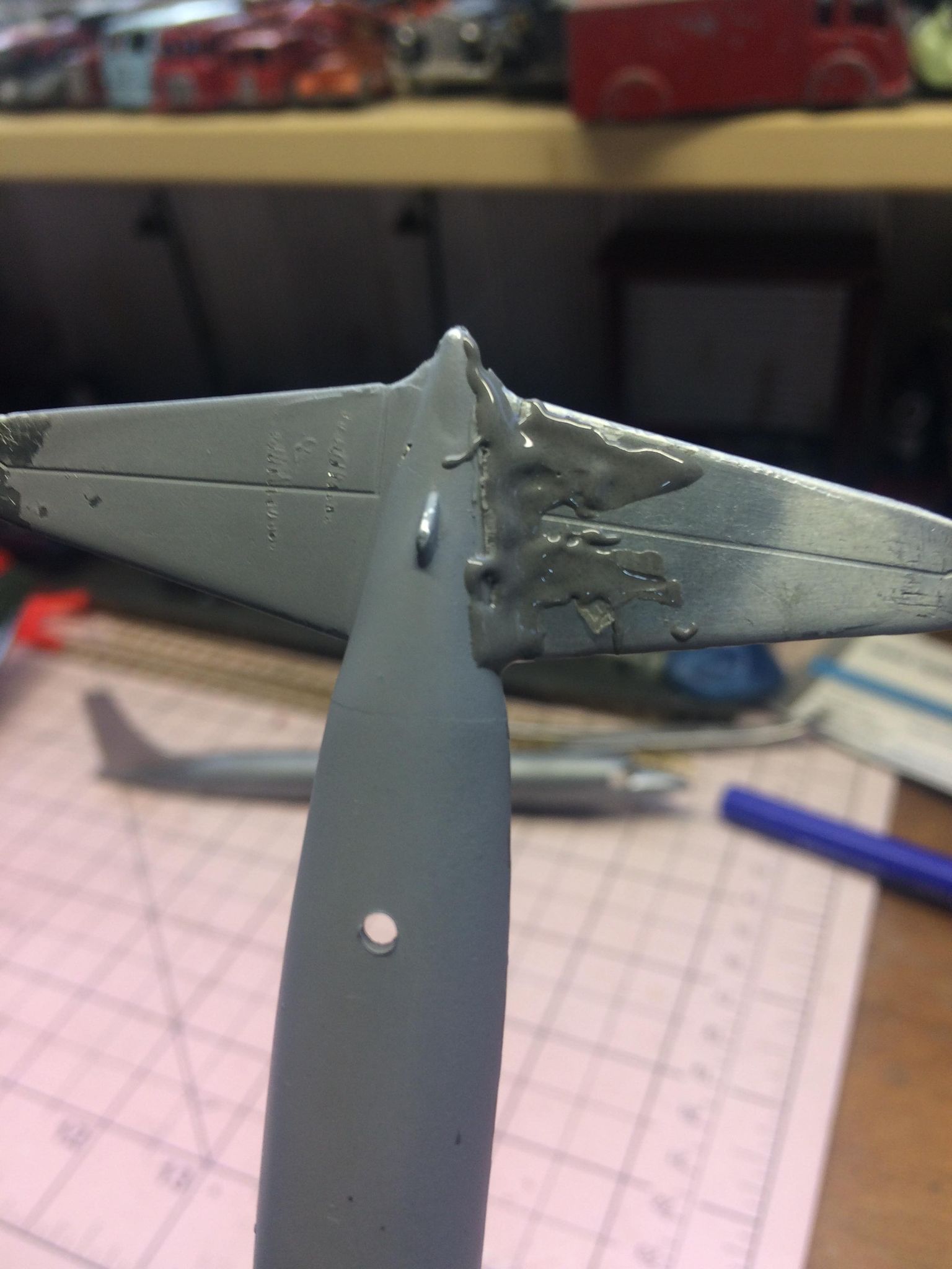

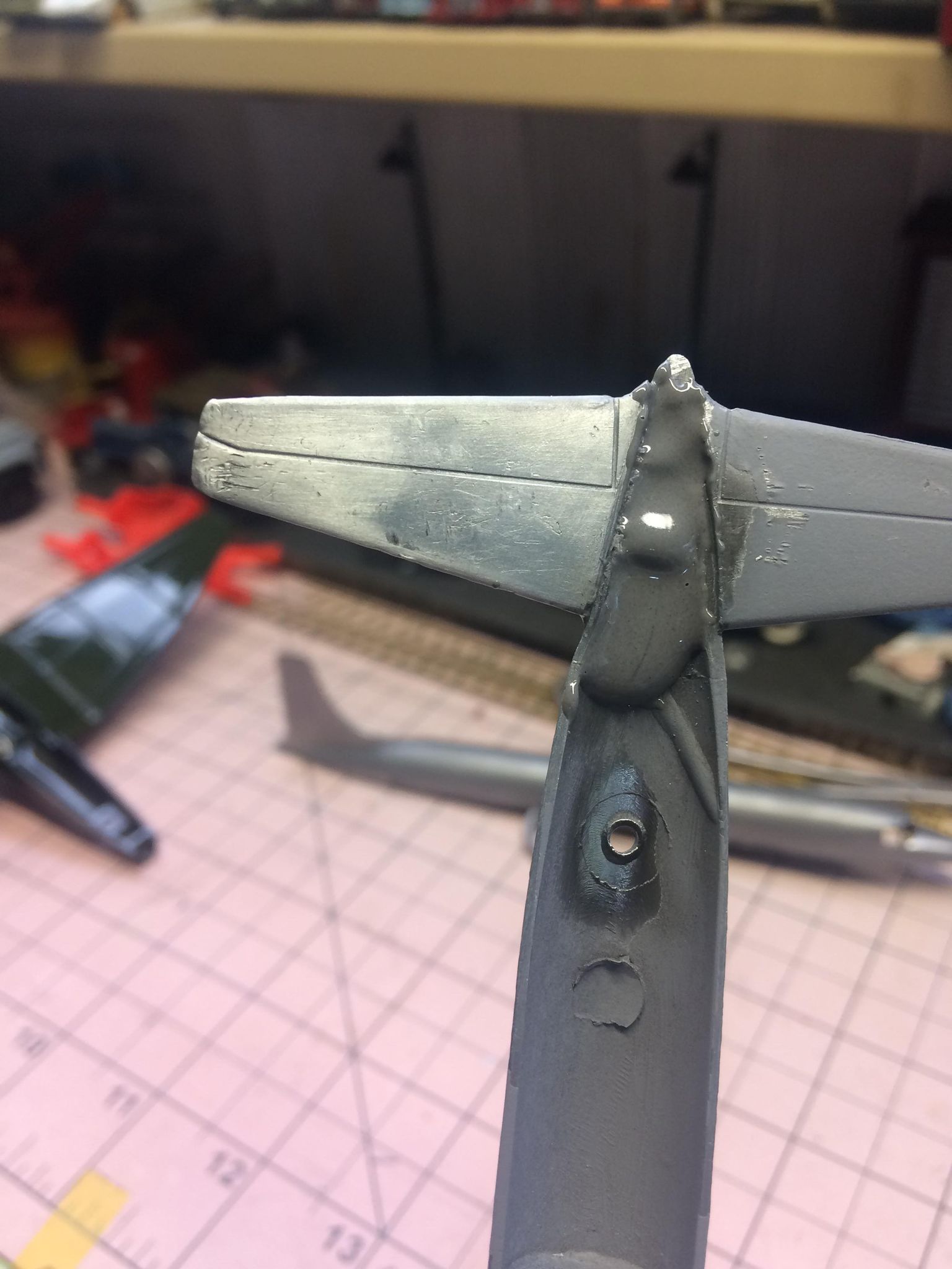

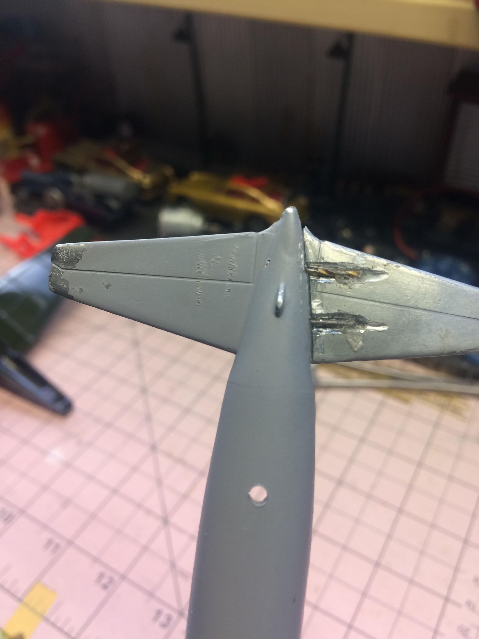

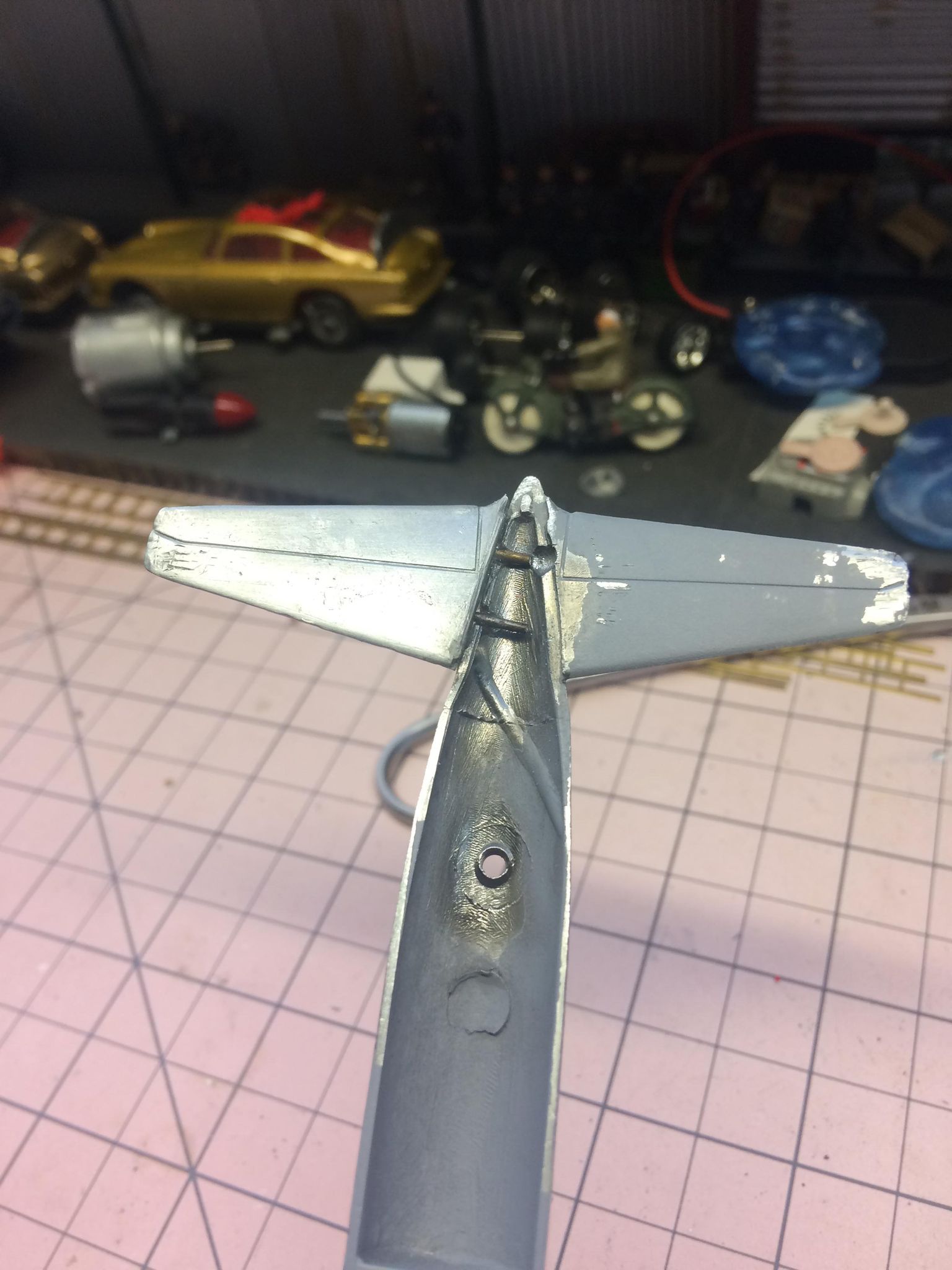

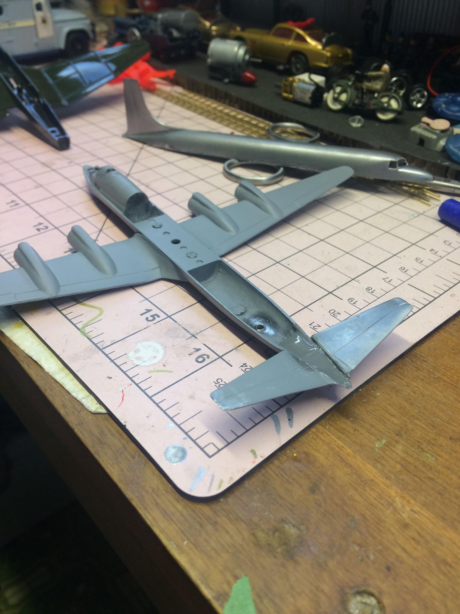

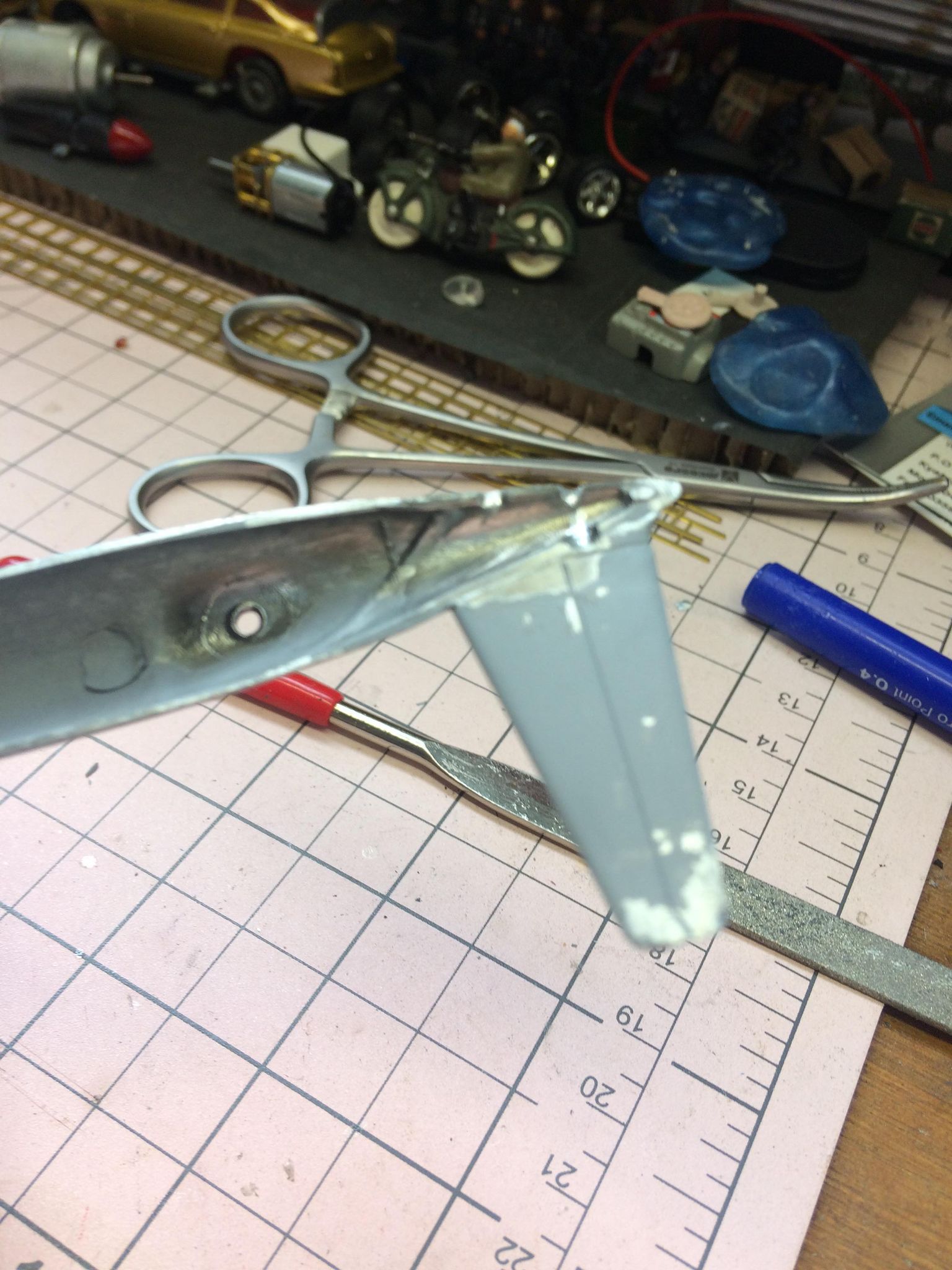

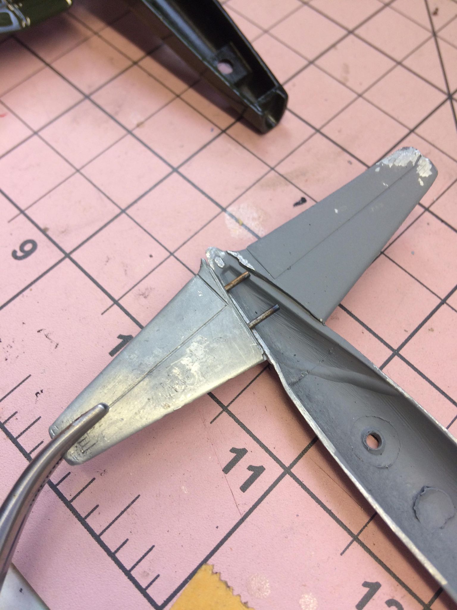

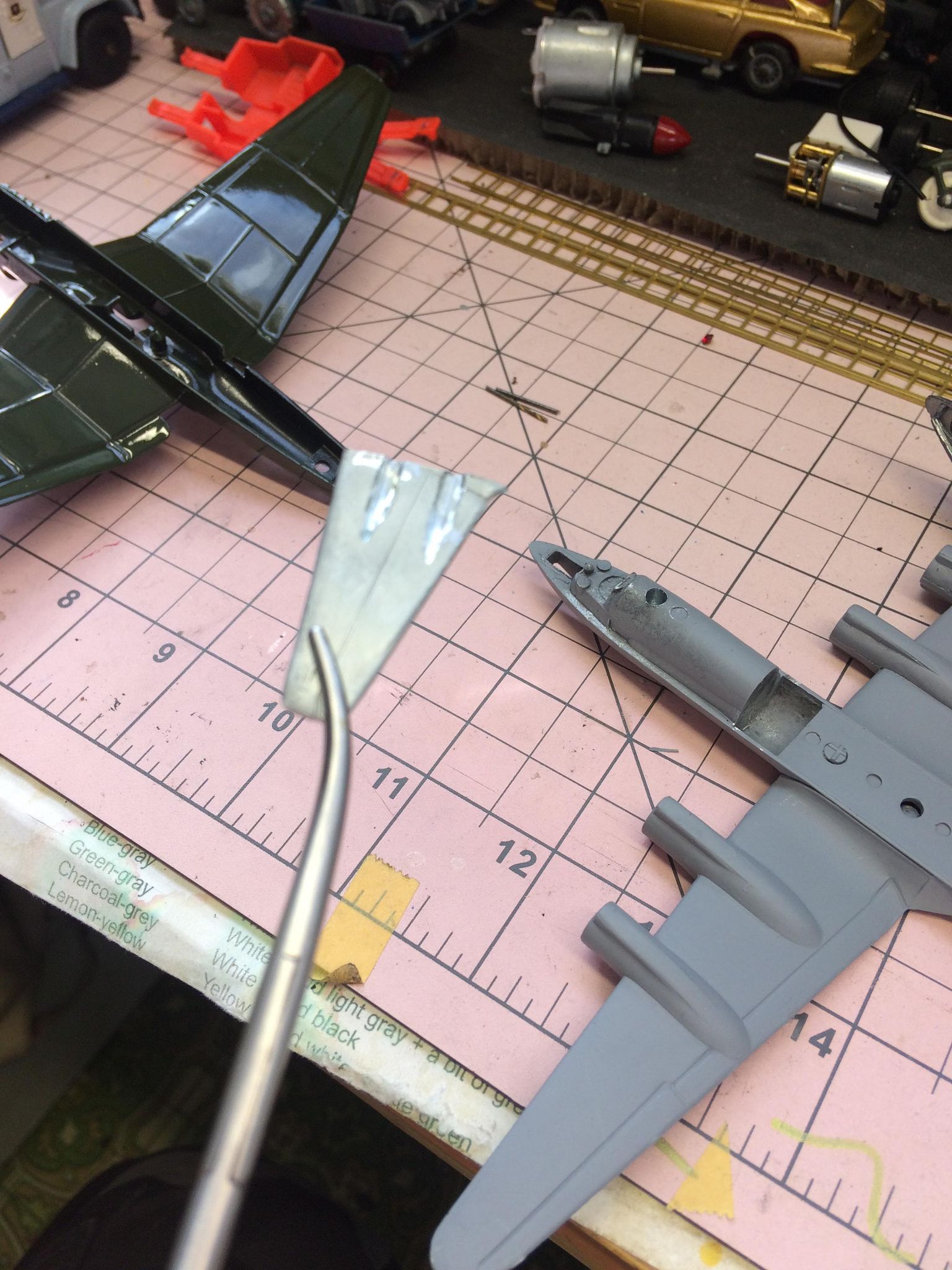

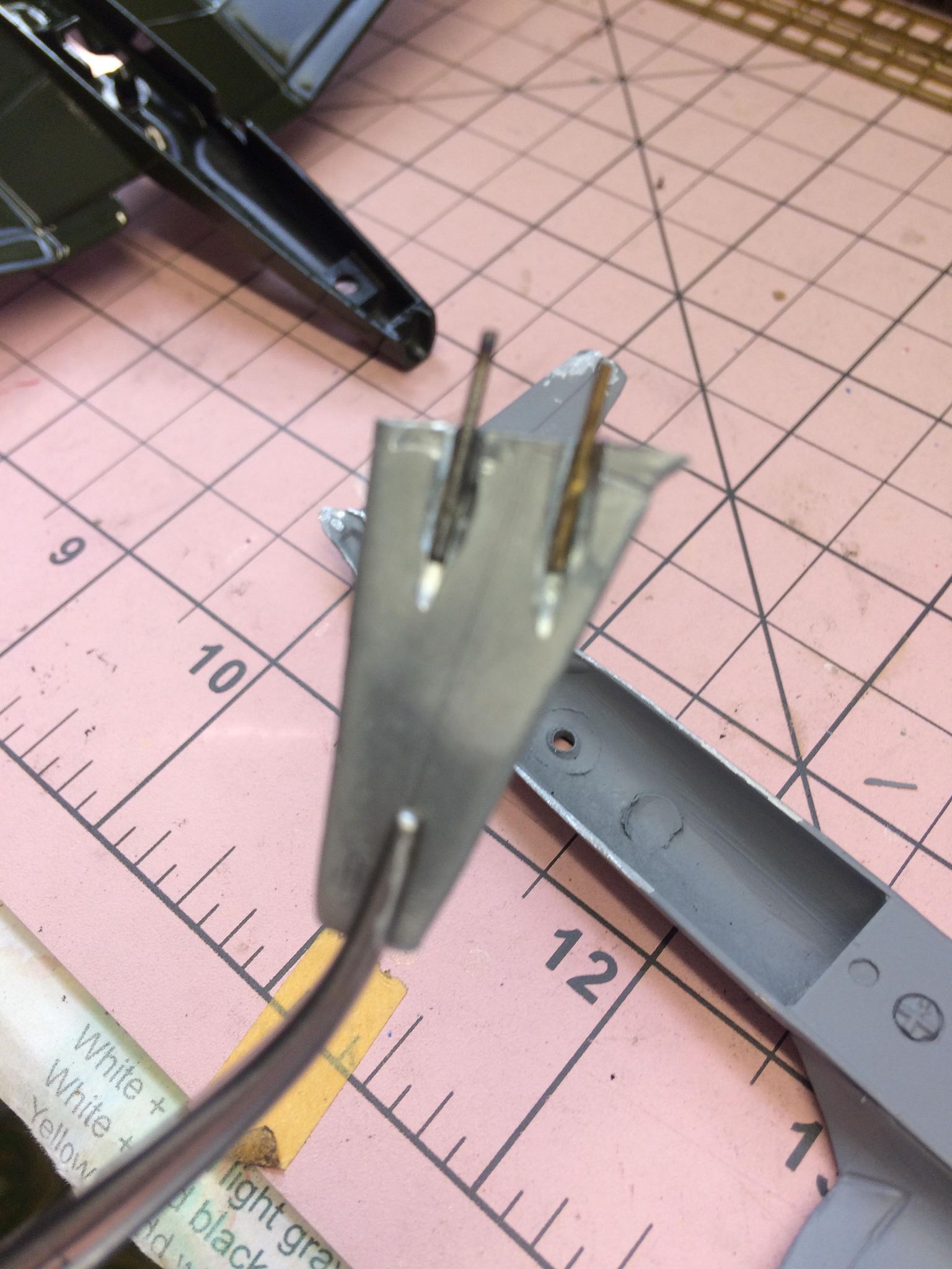

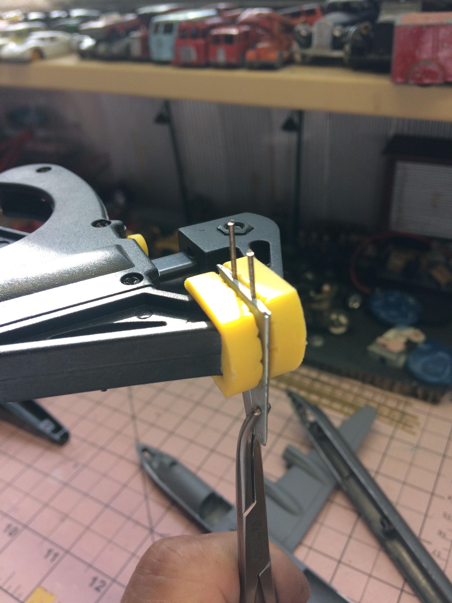

ParticipantWhile waiting for paint to dry I made a start on reattaching tail fin to DC 7 hope pictures are self explaining , my aim is to make it strong enough to be handled once again with out fear of bits falling off .Epoxy is JB Weld Metal 24 hour setting , takes a while to harden off but once set its easy to sand back.In a couple of days I will sand epoxy smooth and adjust to make both body parts fit perfectly before trying to replace broken rear fixing pin .
Basically posting steps to show anyone who may have damaged wings on aircraft that most can be repaired they just take time .juli 10, 2021 kl. 23:43 #79418Stroget
